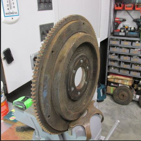

I removed the flywheel from my 76 225 Dart Sport.
There is a huge inertia ring cast into the back of the flywheel.
122 tooth flywheel with standard clutch pattern, around 10 inches.
Starter teeth are pretty chewed up, so I was going to swap with a better wheel I have.
What is the deal with the big ring flywheel?

Low Horsepower, maybe.....
Heavy Car, "It's a Lite" for crying out loud!
High Gear, 1st is a 3.09 for crying out loud!

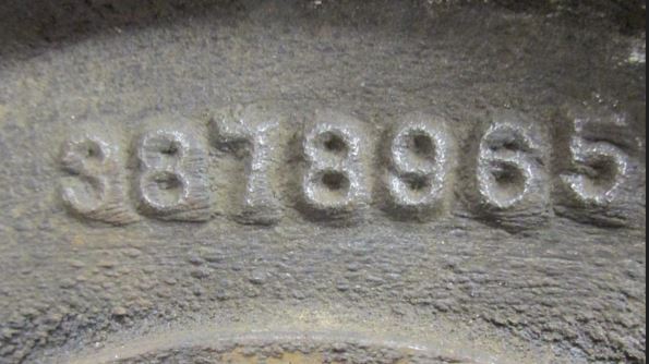

28 Lbs 3878965
VS
23 Lbs. 122 Tooth Flywheel, no inertial ring. 2128290
Ring Cast Number.
PostPosted: Fri Jan 16, 2026 9:45 am
Posts: 9355
It also looks like that ring would be pretty close to the back of the block.
PostPosted: Fri Jan 16, 2026 9:51 am
Posts: 10282
Thanks Stan!
PostPosted: Fri Jan 16, 2026 10:29 am
Posts: 2652
It was on the engine, so it fits.
PostPosted: Fri Jan 16, 2026 11:39 pm
Posts: 424
Location: SW PA
Stan, that appears to be offset back, like it's for the bellhousing adapter stuff of the '70's....without using a spacer.
