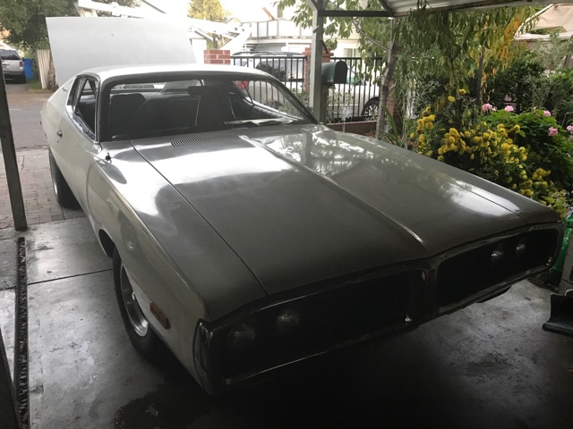

Hey! New to Forum, and new to the Chrysler Slant 6. I traded about 2 months ago straight across a 2005 mazda miata for this cherry, 72' Dodge Charger, original slant 6 and 3 on the tree. Now been converted to 3 on the floor (sad but still fun) one of a little over 900 produced that year with the slant. I traded up because this was one of my dream cars at heart couldn't pass on such a nice old charger. Runs great with original motor, fires rite up idles good. I think although i will rebuild it, seems like a simple enough motor. What kind of price am i looking at for an at home rebuild? I will dissassemble of corse and reassemble, just have the machine work done professionaly. Im on a budget id say under 3k. And not looking for crazy hp or torque, just to refresh the motor

Hello and welcome! Thanks for keeping the slant six in your Charger.
With a $3k budget for a full rebuild, my recommendation is to spend th emoney on the head, exhaust, and ignition system, in that order. Spend the money and time to get the head rebuilt and have larger valves installed with porting. If you can't get the valves, at least do porting and backcutting. Do the measuring and math to get the head milled to have a true dynamic compression ratio of about 8:1.
Install a 2 1/4 inch exhaust line to a free flowing muffler, then 2 inch pipe after the muffler (if you like quiet) or 2 1/4 if that is your preference.
Finally, if you have the money left over, upgrade the ignition system to an HEI ignition and spend the time to fine-tune the vacuum and mechanical advance systems in the distributor.
All of this assumes that basics like suspension and brakes are in good working order. Always upgrade the brakes to match the performance of the motor. Other good upgrades include updating the seatbelts to modern three point belts and ditching the factory two-piece lap and shoulder belt system.
Good luck and keep us posted how your project progresses.

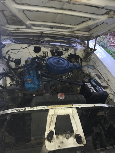

Well, I wanted to rebuild it because im curious of how everythings doing in the motor. I changed the oil first thing when i got the car home, it was black and gnarly. And after i changed it and threw a nice new Wix racing filter on it, was almost just as dirty as before. The Charger only has 14,000 on the odo rite now. But im sure this car sat for a long while in its life, and it could really have 114000 on it. Damn reliable motor though, no leaks original starter. I replaced the drive belt, battery cables, ignition lock cylinder and both rad hoses, resealed the valve cover and have put fresh coolant in it. I could just cruise this baby until i run into an issue with the motor. All ive done soo far is just safe preventive maintenance.

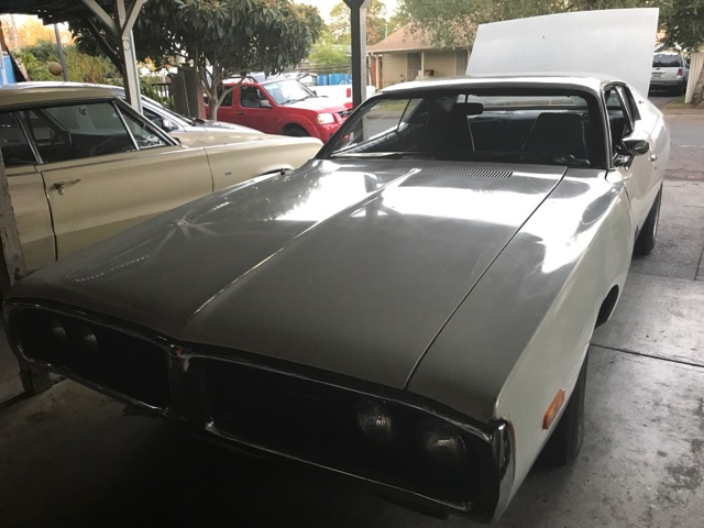

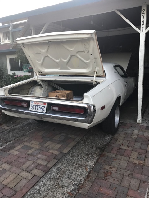

More pics of when i got it (need to take fresh pics but its raining)
