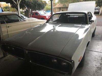

Hey! New to Forum, and new to the Chrysler Slant 6. I traded about 2 months ago straight across a 2005 mazda miata for this cherry, 72' Dodge Charger, original slant 6 and 3 on the tree. Now been converted to 3 on the floor (sad but still fun) one of a little over 900 produced that year with the slant. I traded up because this was one of my dream cars at heart couldn't pass on such a nice old charger. Runs great with original motor, fires rite up idles good. I think although i will rebuild it, seems like a simple enough motor. What kind of price am i looking at for an at home rebuild? I will dissassemble of corse and reassemble, just have the machine work done professionaly. Im on a budget id say under 3k. And not looking for crazy hp or torque, just to refresh the motor

Hello and welcome! Thanks for keeping the slant six in your Charger.
With a $3k budget for a full rebuild, my recommendation is to spend th emoney on the head, exhaust, and ignition system, in that order. Spend the money and time to get the head rebuilt and have larger valves installed with porting. If you can't get the valves, at least do porting and backcutting. Do the measuring and math to get the head milled to have a true dynamic compression ratio of about 8:1.
Install a 2 1/4 inch exhaust line to a free flowing muffler, then 2 inch pipe after the muffler (if you like quiet) or 2 1/4 if that is your preference.
Finally, if you have the money left over, upgrade the ignition system to an HEI ignition and spend the time to fine-tune the vacuum and mechanical advance systems in the distributor.
All of this assumes that basics like suspension and brakes are in good working order. Always upgrade the brakes to match the performance of the motor. Other good upgrades include updating the seatbelts to modern three point belts and ditching the factory two-piece lap and shoulder belt system.
Good luck and keep us posted how your project progresses.

Personally, for a basically stock rebuild, I would not spend the money for large valves. Just a head rebuild, (guides, hardened exhaust seats, cut valves, and seats), and if you can do it yourself, just cleanup the bowls a little bit. Definatly mill the head to increase compression ratio. As for the short block, just a stock rebuild, maybe a mild cam. Doing the assemble, disassembly work yourself, there is no reason you cannot stay well within your budget.

I agree, mill the head to increase compression(8:1 minimum-no more than 9:1). Basic valve job (a 72 should already have hardened seats), upgrade the ignition to electronic (it may already have it). Upgrade the exhaust as described and find a factory 2-bbl setup. Use the factory stuff and it will look like it came that way. See what sort of gear is in the rear axle, 3.23 or 3.55 would be great, if not already equipped. I don't see why you couldn't easily do all that for under $2k.

If the car runs well, why do you want to rebuild it? You run the risk of goofing up things that are working well, both as part of the core engine, and ancillary accessories and parts. Many machine shops make mistakes, which can cost lots of time and money if you do not know how to check their work before assembly and starting.
In other words, what do you want to improve about this engine or car?

If the motor is running fine right now, just leave it alone and enjoy it!

So, spend your money on brakes and handling............
