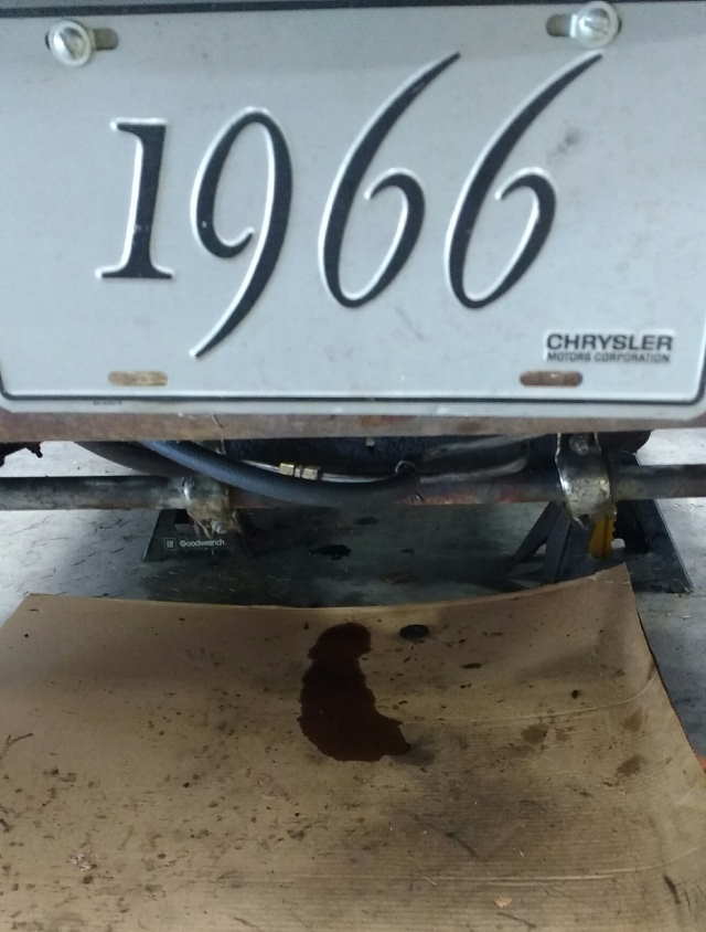

Unfortunately, something went wrong. Hopefully I can just get a big gob of RTV on the back as I think it was the rear rubber seal that isn't doing its job.
File comment: Leak.

Looks like it was the oil pan gasket there and not the rear main seal, at least. I'll see if a blob of RTV is enough.
On second thought, probably better to just change out the gasket.

Update - changed the gasket, looks like everything's OK.
