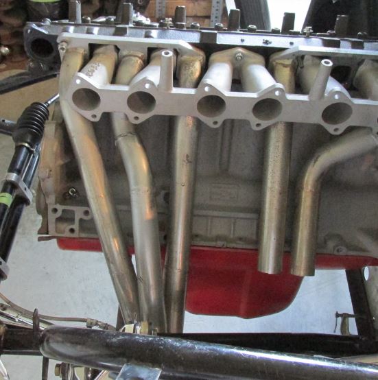

Front header section has been cut, welded, beat on and now fits chassis.
Rear section awaits.

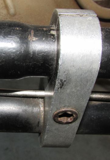

Both steering arms have been fitted with countersunk screws to prevent ball joint rips.

After too many mistakes with the 4130 chrome moly and header tubes....
I purchased a TIG welder and have been teaching myself how to weld.

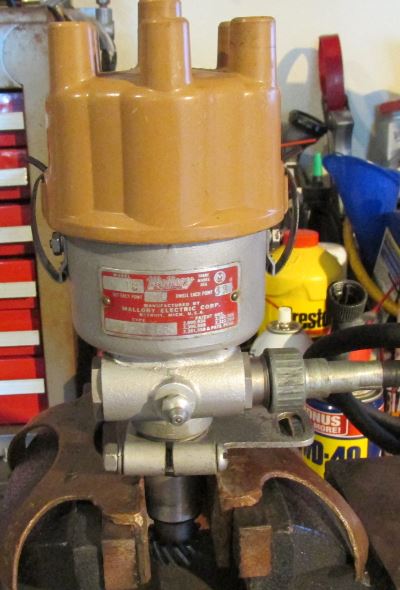

I found a 10 quart cast aluminum oil pan and a tach drive distributor.
Countersunk screws in Passenger side spindle.
Rack and Pinion mount re-machined to move outboard for damper clearance.

...I found a 10 quart cast aluminum oil pan...
Somebody made such a thing?
Want!
--> The Diesel Corvette <--
PostPosted: Fri Aug 14, 2020 5:00 am
Posts: 1452
Want!
Yeah, you can't just casually mention something like that without pictures.
