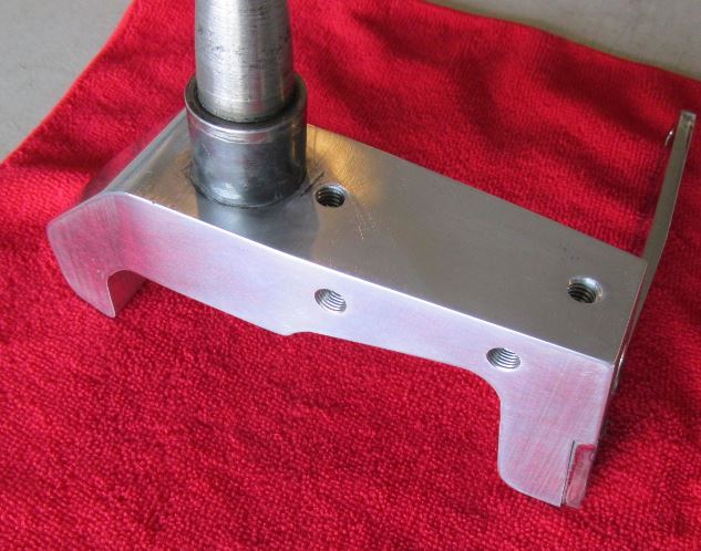

What are the parts in the More pics thread?

Spindle and the R&P mount bracket.
