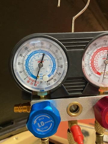

routed the AC lines and started the evacuation process today
ran the vacuum pump for 30 minutes and it had pulled down to 28 inches of vacuum
shut the pump off for 10 minutes and the vacuum held
started the pump back up and ran another 10 minutes, shut it down and will re check in the AM
so far so good!
