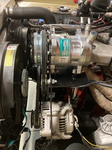

The next project is to finish the AC install. I do intend to drive the car to races and events, having climate control in the car will make it all more enjoyable.
I am using a kit from Classic Auto Air, it is a very complete kit, although I had them delete the AC compressor mount as I had purchased a slant compressor mount from Charlie S as I like the way he positioned the bracket to fit the crank pulley in the OE or inside position. The Classic kit puts the crank pully outboard. I also had Classic not crimp the hoses as I planed to route the hoses in the fender well and under the radiator to hide them.
photos show the through the inner fender piping and the AC compressor mount and the left side alternator and the hoses cut to length with fittings.

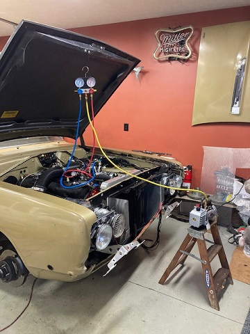

routed the AC lines and started the evacuation process today
ran the vacuum pump for 30 minutes and it had pulled down to 28 inches of vacuum
shut the pump off for 10 minutes and the vacuum held
started the pump back up and ran another 10 minutes, shut it down and will re check in the AM
so far so good!
