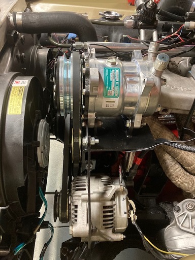

The next project is to finish the AC install. I do intend to drive the car to races and events, having climate control in the car will make it all more enjoyable.
I am using a kit from Classic Auto Air, it is a very complete kit, although I had them delete the AC compressor mount as I had purchased a slant compressor mount from Charlie S as I like the way he positioned the bracket to fit the crank pulley in the OE or inside position. The Classic kit puts the crank pully outboard. I also had Classic not crimp the hoses as I planed to route the hoses in the fender well and under the radiator to hide them.
photos show the through the inner fender piping and the AC compressor mount and the left side alternator and the hoses cut to length with fittings.
