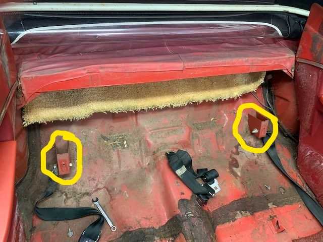

guess what, it was way easier then expected...
when the seat is removed, there where just 2 bolts holding these iron strips in place right where the seatbelts are attatched (seatbelts are from the '70s, but they keep my kids (8 and 4yrs old in place).
after removing the 2 bolts it was simply slide upwards and take the back rest out. the roof-cover simply slides out to the side.

PostPosted: Tue Feb 22, 2022 12:27 pm
Posts: 17670
Oh yeah, that is very different than the attachments on a sedan or coupe. Sorry I could not be of more specific help.

PostPosted: Wed Feb 23, 2022 5:48 am
Posts: 79
Location: Netherlands
what I don't understand is; it is not attached on the top. So wondering if there's some (heavy) luggage in the trunk, and you brake, wouldn't it just blast right through it?
PostPosted: Wed Feb 23, 2022 7:12 am
Posts: 17670
Yes, that is strange. The sedans/coupes have bottom and top mounting.

PostPosted: Thu Feb 24, 2022 12:32 am
Posts: 79
I don't know anyone that puts large amounts of weight or volume of cargo in their '64 Dart...
Not like anyone that I know hauls engine blocks around or anything in the trunk..... :lol: :lol: :lol: :lol:
I was kind of figuring that out; the car has 4 drum brakes... an emergency stop is out of the question...
Although I've had it on the highway at 80mph I didn't like to drive at that speed with it. Taking it 1500miles to Ireland this summer, through Wales, the UK, northwest of France, Belgium and The Netherlands will all be done by two lane express way's, scenic routes and even backroads. The max speed won't be over 60mph.
(This week though, I'll be skiing in Austria, flying the Autobahn through Germany at 140mph is better in a 2021 car as a 1964 car :roll: )
Still though, regarding the rear seat, it should be fastened on the top. Is there like a mechanic-book of the Dart that shows how it supposed to be?
