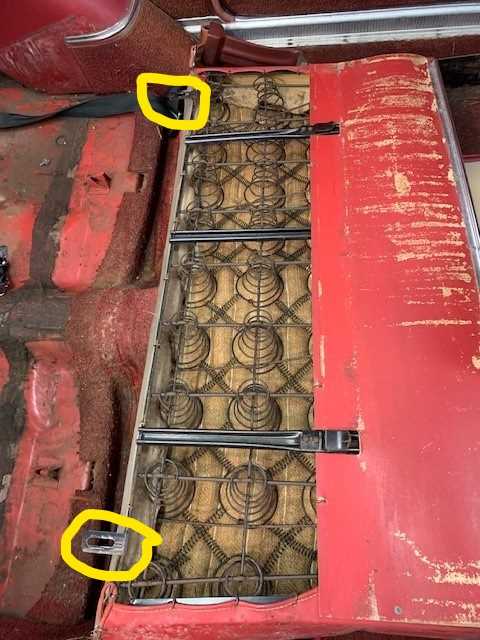

guess what, it was way easier then expected...
when the seat is removed, there where just 2 bolts holding these iron strips in place right where the seatbelts are attatched (seatbelts are from the '70s, but they keep my kids (8 and 4yrs old in place).
after removing the 2 bolts it was simply slide upwards and take the back rest out. the roof-cover simply slides out to the side.

PostPosted: Tue Feb 22, 2022 12:27 pm
Posts: 17675
Oh yeah, that is very different than the attachments on a sedan or coupe. Sorry I could not be of more specific help.

PostPosted: Wed Feb 23, 2022 5:48 am
Posts: 79
Location: Netherlands
what I don't understand is; it is not attached on the top. So wondering if there's some (heavy) luggage in the trunk, and you brake, wouldn't it just blast right through it?
PostPosted: Wed Feb 23, 2022 7:12 am
Posts: 17675
Yes, that is strange. The sedans/coupes have bottom and top mounting.
