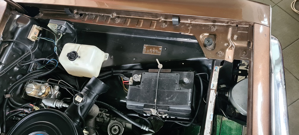

Does anyone has any pictures or diagrams how factory air intake flex hose should be routed and where connected from the air box on a super six option in an A-body in the 70's? Specifically in '73 Dart Sport models?
This seems to be the last element I have missing in my 198 to 225 super six conversion. Thanks!
Attached are pictures of my current engine bay without the hose.
Rad

The A-Body never had a Super Six option, so there is no provision for the air hose off the air cleaner. On the F-bodies, the inlet was between the battery and the radiator, where it attached to a plastic pipe that had its inlet opening down by the bumper.
The Super Six air cleaner is nothing more then a 318 air cleaner with a fancy decal. You could always substitute the base from a early '70s 318 air cleaner to get a more period correct look.
Nice looking engine compartment.
