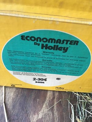

all trans for cars 75-77 After market replacement not oem, not lean burn or manifold vacuum, might be ecomaster https://www.forabodiesonly.com/mopar/th ... rs.456595/ R 8994 AAA does your carb have the letters?

PostPosted: Wed Dec 20, 2023 7:41 am
Posts: 1603
with the letters
PostPosted: Wed Dec 20, 2023 7:47 am
Posts: 1603
Ecomaster

Those Economaster 1945s are a really good score. They have all the updates and refinements (and fixes) absent in the '74-'76 1945s, plus more. They come with a lean main jet, but that is easily and inexpensively changed for a thoughtfully-chosen larger one, and then the engine will run great.
