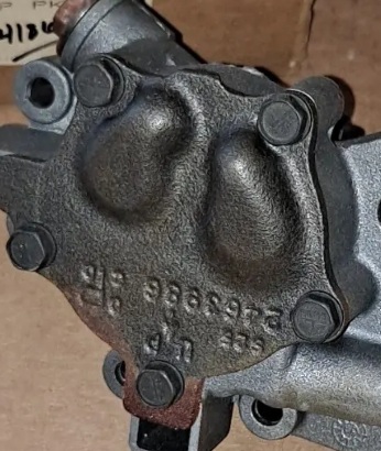

Forgot to post the awesome power brake vacuum attachment and the cooked mud dauber nest.
Forgot to add the oil pump picture from the auction. Same cover as my original.

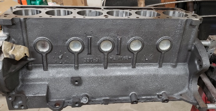

Thanks. I noticed the cylinder and lifter bores have a little surface rust. Should I go spray them with oil? (CLP)
ETA. I wiped down the bores with motor oil. Nice clean block ready for paint. I'm thinking light blue, not black. (Original color) It's a Nightwatch dark blue truck. Thoughts on color? Not red.

Did you need 60 over to clean things up? I see that's what you show in the compression ratio calculator
PostPosted: Tue Feb 27, 2024 6:45 pm
Posts: 9500
How did you get the block soooo clean?

The machine shop cleaned it and wrapped it in a bag. Pictures are from just after unloading and back on the engine stand.
