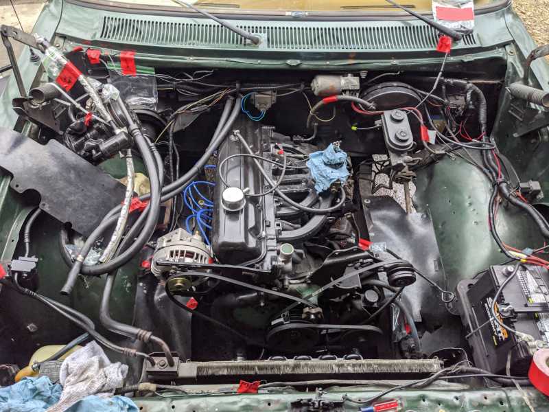

I'm attaching pictures from LAST YEAR, after we had ultimately found ourselves guessing on cam timing. You can see our marks on the sprockets.
I've also posted a picture of the engine bay, with the engine installed BEFORE we pulled it and overhauled it. It looks nice and painted, but it was worn to pieces inside..

I see adjustable rocker arms, so I guess you've either built a pre-'80 (solid-lifter) motor for this truck, or you've converted an '81-up (hydro-lifter) engine to solid lifters. That's fine as long as you have all the correct valvetrain parts, including camshaft, not a mashup of some hydro and some solid parts—and if you've converted a hydro-lifter motor, you've taken steps to reduce oil volume to the top end.
Speaking of oil to the top end, that looks like an aftermarket valve cover. Those usually don't have baffles in, which will mean high oil consumption, fouled spark plugs, and pinging. Read up on this and how best to fix it (other than installing a stock valve cover with baffles, which is probably the best/easiest/least costly way) here.

Solid lifter head. Spark plug tubes in the photo. I see no reason to try and reduce oil flow if switching to solid valve train from hydraulic. Actually if the cam is on a earlier blank the oil will be reduced automatically by the different oil metering of the rear cam journal. Solid cam has two intersecting oil holes in the rear cam journal, where the Hydraulic cam has a full groove. But many "new" solid cams are ground on hydraulic blanks and have the groove.

I might agree with you if not for that valve covr; the combination of excessive top-end oil and a no-baffles valve cover will have too much oil entering the intake tract via the PCV.

2) I had no idea it was a mismatched valve cover. From what I know about the truck, I suspect it was assembled by a diesel shop to be used as a parts runner and they probably used what they had. So, it isn't surprising that it didn't come with the original cover. I'll read up on your reference and determine what to do to make sure the cover gets corrected in some way.
Update: After reading the reference material and and doing minimal Google-foo, I determined that the valve cover on mine is a generic after-market that can be found on eBay or Amazon. It is no more than a stamped sheet of metal and has no baffles. Very luckily, I found a listing on eBay where someone is refinishing stock Chrysler slant six valve covers (with proper baffles) and so I ordered one.
