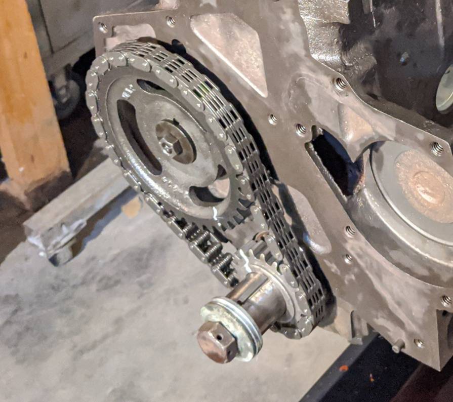

I'm attaching pictures from LAST YEAR, after we had ultimately found ourselves guessing on cam timing. You can see our marks on the sprockets.

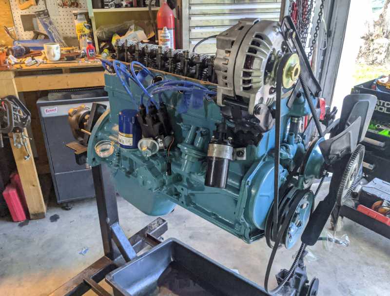

I've also posted a picture of the engine bay, with the engine installed BEFORE we pulled it and overhauled it. It looks nice and painted, but it was worn to pieces inside..

I'm now confident that my cam timing is off a tooth.
You just can't move it a tooth. It may be off just as bad the other direction. Your going to have to figure out how to degree it if you want it in right. Before you pull the damper and everything off, mount your degree wheel again and check where it is at before you pull it apart. We'll help you! :D

Rick's right. And in complete sympathy with your difficulties, I quote John Jerome: "You can't get the cam timing right until the cam timing's right". That's from Truck, his excellent 1977 book (also available to read for free on the Internet Archive here and here).
Yes, you can change the cam timing without dropping the oil pan. You'll have to pull the timing cover, and you'll still have a fight with parts of the oil pan gasket—the notoriously-difficult-to-seal "Bermuda Triangle" at the right front corner, its corresponding left front corner, and the rest of the gasket area sealing the bottom of the timing cover to the front of the oil pan.
I see adjustable rocker arms, so I guess you've either built a pre-'80 (solid-lifter) motor for this truck, or you've converted an '81-up (hydro-lifter) engine to solid lifters. That's fine as long as you have all the correct valvetrain parts, including camshaft, not a mashup of some hydro and some solid parts—and if you've converted a hydro-lifter motor, you've taken steps to reduce oil volume to the top end.
Speaking of oil to the top end, that looks like an aftermarket valve cover. Those usually don't have baffles in, which will mean high oil consumption, fouled spark plugs, and pinging. Read up on this and how best to fix it (other than installing a stock valve cover with baffles, which is probably the best/easiest/least costly way) here.

Solid lifter head. Spark plug tubes in the photo. I see no reason to try and reduce oil flow if switching to solid valve train from hydraulic. Actually if the cam is on a earlier blank the oil will be reduced automatically by the different oil metering of the rear cam journal. Solid cam has two intersecting oil holes in the rear cam journal, where the Hydraulic cam has a full groove. But many "new" solid cams are ground on hydraulic blanks and have the groove.

I might agree with you if not for that valve covr; the combination of excessive top-end oil and a no-baffles valve cover will have too much oil entering the intake tract via the PCV.

2) I had no idea it was a mismatched valve cover. From what I know about the truck, I suspect it was assembled by a diesel shop to be used as a parts runner and they probably used what they had. So, it isn't surprising that it didn't come with the original cover. I'll read up on your reference and determine what to do to make sure the cover gets corrected in some way.
Update: After reading the reference material and and doing minimal Google-foo, I determined that the valve cover on mine is a generic after-market that can be found on eBay or Amazon. It is no more than a stamped sheet of metal and has no baffles. Very luckily, I found a listing on eBay where someone is refinishing stock Chrysler slant six valve covers (with proper baffles) and so I ordered one.

I've done some cursory skimming on the 'net and through my books and I've not seen anyone degree a Slant Six cam with the head on. I need to study the process again in detail, which I will do when I have some time to dedicate to it, but I'm not sure why it wouldn't be possible to do, albeit not ideal. I do see vids where people accomplish this on other makes (E.G. LS motors). I really don't want to be pulling the head again if I don't absolutely have to. Have you done it?
I have done it several times. You need to use a piston stop in the #1 spark plug hole, to find TDC. Remove the valve cover, Best to remove the rocker assy. and use the dial indicator on the #1 intake pushrod. Or you can do like I did and "glued" three lifters together and put these in the #1 intake lifter hole the dial indicator on these. The hardest part is fitting a degree wheel to the engine while in the car.

I happen to be running the same spec cam myself, which I bought used... from Charlie S. So hopefully there's enough collective knowledge about that cam in this thread to get you sorted! The one I have turned out to be timed exactly according to its cam card and I was able to install it with the timing chain at its default location.
I see you're using a conventional set of sprockets, not something like the Roll-Master chain with the multiple keyways. The picture you posted shows the timing chain installed properly and all the markings lined up. So if it's still installed as in the picture, and if everything about the cam and timing chain are made to tolerances, everything will be lined up as it should. The bad news is if you have something out of tolerance, it will be tricky to adjust. If it's not too far off, you can use an offset crank key, but you may end up needing to get the Roll-Master chain if you can't get things right with the chain you have.
That's valuable info - thanks much. It is put together now exactly as pictured.
