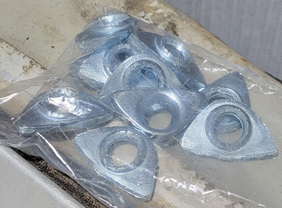

My new Dorman exhaust manifold is here and it came with new triangle washers as well as the brass washers and slotted nuts.
Any reason not to use brass nuts on the other studs?

I like to use brass nuts on the non-end studs; they never seize.

Yes, That would make it too easy to take apart the manifolds in 20 years. :) :)
