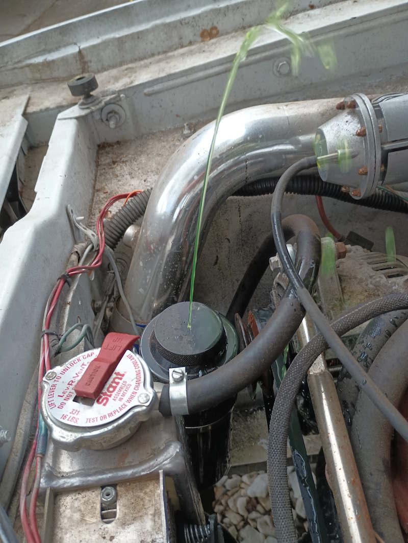

Another idle test had the temperature creep up a little further before I shut it down. Also, this happened on shutdown.
File comment: View of the overflow tank.
Did a bit of playing with the timing, but I'm wondering if I need to find a way to drop the idle speed (around 850-950 RPM in Drive, 6 degrees of timing produces the lower figure while 12 degrees goes toward the higher end) or add more airflow. And probably more overflow tank capacity; this small overflow tank looks a bit undersized.
