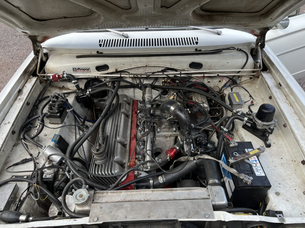

Here it is with the turbo+efi setup. The rod was exactly the same with Carter BBD. I just chose/made hole to carburetor link which makes a little shorter movement to rod as the 904 lever does. Then I adjust the rod so that 100% WOT at the throttle pull the 904 lever to the end.

Posts: 25041
That is nicely-done work, but it is not safe. See here for explanation.
(Also…how are you ventilating your crankcase? From this pic of your engine bay, it looks as if you aren't.)

I dont agree. I have double or triple return springs there to get throttle closed and it has been doing well from 1999.
However the original factory throttle return system was just a single spring which I have got broken more than once. The factory system has built so all mass was fighting against that single spring.
Crankase is wentilated to a catch can which has set underpressurized with an electric vacuum pump driven by Maxxecu engine controller by measuring the crankcase pressure continuously From an connection at the oil pan. The fumes from the electric pump outlet are routed to the tube in between the K&N element and turbo inlet. For higher power the turbo makes the most of the underpressure to the crank. The rest of time the pump does the job. Crankcase pressure is compared to the athmosphere pressure and stays below it all the time.
Pictures are not optimized for the presentation on going as my hobby is not to be an influencer in the media but keep the old Dodge running and keep it fast enough for todays traffic.
