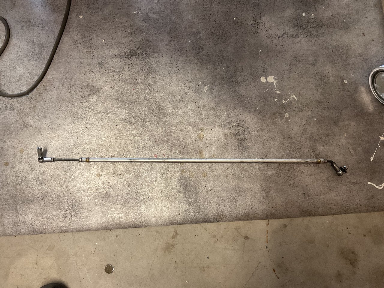

Here it is!
Long time ago when I got bought a supersix setup including cast iron 2 bbl manifold and Carter BBD from a donor car I dint pick up the kickdown linkage. As it was Aspen it probably wont fit to my early A-body either.
So I had manifold installed and carburetor tuned, engine was at drive condition but I havent a kick down system. I had to build one!
I went to closest hardware store. I picked up a 8/10mm aluminum tube, couple of expanding wall plugs with M6 threads and couple of brass rings with 10 mm hole. Those are used at waterline copper tube joints. I also bought M6 threaded rod and 2 ball ends. Then I collected the system presented in the picture.
The left end in the part is for carburetor. Right end with bent rod is to A904 link. At first I screwed the bottom end to the 904 link. Next I measured the max movement from idle end of the 904 link to the "kickdown" position. Then I drilled to carburetor a hole (with some calculations and tests) which made similar but slightly less move from idle to WOT. You can see I have 10cm treaded area for adjustment. I used it so that when carbutetor is at WOT the 904 link touches to end.
I was ready from beginning.
Does it last long?
Yes it does. I built this system at 1999 and it is still in use. Now I have fuel injection but the throttle body shaft is at the same point as was the Carter was before.
This was and is my solution for kickdown of SUPER SIX.

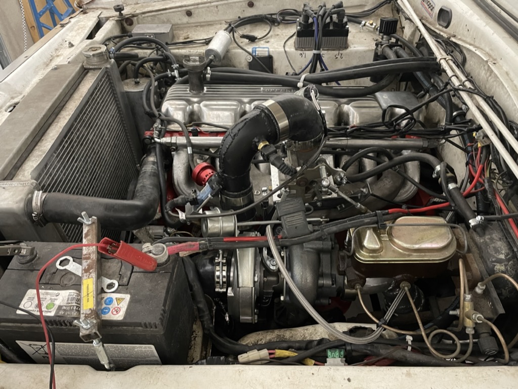

Here it is with the turbo+efi setup. The rod was exactly the same with Carter BBD. I just chose/made hole to carburetor link which makes a little shorter movement to rod as the 904 lever does. Then I adjust the rod so that 100% WOT at the throttle pull the 904 lever to the end.

(Also…how are you ventilating your crankcase? From this pic of your engine bay, it looks as if you aren't.)

Crankase is wentilated to a catch can which has set underpressurized with an electric vacuum pump driven by Maxxecu engine controller by measuring the crankcase pressure continuously From an connection at the oil pan. The fumes from the electric pump outlet are routed to the tube in between the K&N element and turbo inlet. For higher power the turbo makes the most of the underpressure to the crank. The rest of time the pump does the job. Crankcase pressure is compared to the athmosphere pressure and stays below it all the time.
Pictures are not optimized for the presentation on going as my hobby is not to be an influencer in the media but keep the old Dodge running and keep it fast enough for todays traffic.
