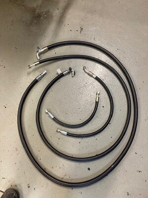

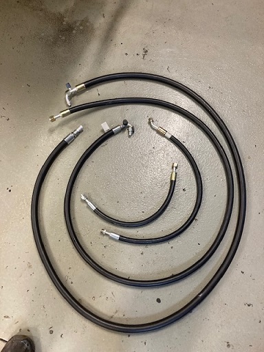

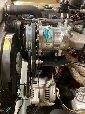

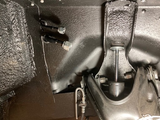

The next project is to finish the AC install. I do intend to drive the car to races and events, having climate control in the car will make it all more enjoyable.
I am using a kit from Classic Auto Air, it is a very complete kit, although I had them delete the AC compressor mount as I had purchased a slant compressor mount from Charlie S as I like the way he positioned the bracket to fit the crank pulley in the OE or inside position. The Classic kit puts the crank pully outboard. I also had Classic not crimp the hoses as I planed to route the hoses in the fender well and under the radiator to hide them.
photos show the through the inner fender piping and the AC compressor mount and the left side alternator and the hoses cut to length with fittings.

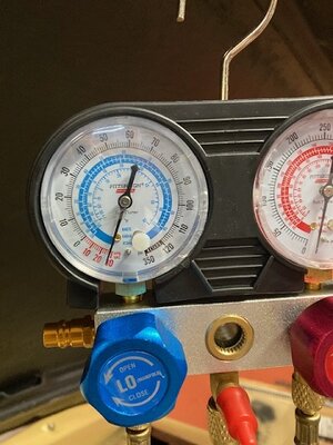

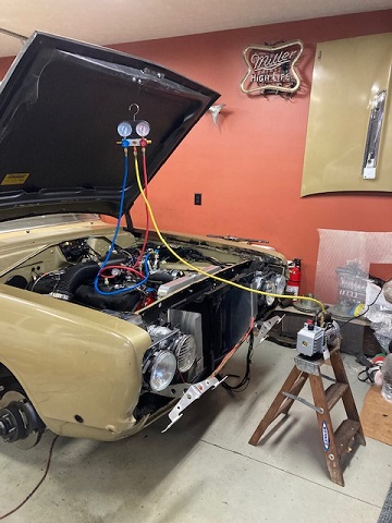

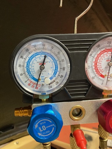

routed the AC lines and started the evacuation process today
ran the vacuum pump for 30 minutes and it had pulled down to 28 inches of vacuum
shut the pump off for 10 minutes and the vacuum held
started the pump back up and ran another 10 minutes, shut it down and will re check in the AM
so far so good!

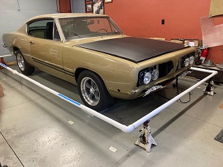

Completed a front end alignment on the 68 Barracuda, The numbers that I got are
Toe 1/16 in each side
Camber + 1.031 Passenger side
Camber + .916 Driver side
Caster +2.525
For comparison, Barracuda alignment settings from a 1968 FSM
Toe 1/8
Camber Left +1/2
Camber Right +1/4
Caster Manual 0 to -1
Caster Power 1/4 to 1 1/4
I used the formulas for the calculations of caster and camber that are in this post.
https://www.slantsix.org/forum/viewtopi ... =4&t=65513
The car has the 73 and up large ball joint upper control arms with the Moog off set bushings, stock lower arms, C body tie rod ends.
The upper control arm adjustors were set with the front bolt rotated all the way out from center and the rear adjustor bolt set all the way in.
I worked a while setting up a string frame to measure toe setting against. I just could never get comfortable that I was really setting up two parallel lines.
My extension tape had flex. I was working alone in the garage. So I made a hard frame of PVC pipe. And I like that. Easy to center around the car, move one side an inch in and the other side moves an inch out. I think it is really robust and will be easy to set up again. I glued one side on each 90 degree fitting and lightly sanded the non glued pipe to allow a full depth fit that can be pulled apart.
I also verified that the rear wheels on the car are square, with no toe. They are.

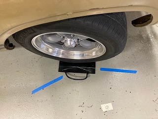

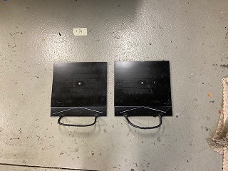

I also made a set of turn plates, used for checking caster. Basically two plates of steel with the bottom plate being a bit wider and marked with the 15 degree angle targets. These are not slide plates, so the car has to be rolled up on them, but that was not difficult to do. The problem that I found is the epoxy floor in my garage is so slick that the entire plate assembly would turn with the tire. I could probably fix that by gluing some rubber to the bottom side, or I may just let that go and make up a set of angle extensions to mark the 15 degree extensions. In the photo I did that with tape.
So I am satisfied with the garage alignment project, between the PVC pipe and the steel plates I spent a little less than $80.00 a shop alignment would cost at least that much. I plan to use this same set up to check and adjust the alignment on the D150 and then maybe again on the 68 B if I swap in aftermarket upper control arms.
A couple of days in the garage, a couple of days of fun.

PostPosted: Thu Nov 05, 2020 7:01 pm
You have positive camber? The top of the tire is more outboard than the bottom?
PostPosted: Thu Nov 05, 2020 7:06 pm
Posts: 3864
yes, one has to look to see it, but it is there
PostPosted: Thu Nov 05, 2020 7:17 pm
You usually try to get a little negative camber for handling..............
PostPosted: Thu Nov 05, 2020 7:47 pm
Posts: 3864
and I think one can do that by backing off the rear adjustor a bit.
I believe a bit of positive camber is said to improve straight line stability
and make for easier steering.
I plan to drive the car a bit and then make adjustments, that was
the reason for being able to do my own garage alignments.
But I am certainly always open to recommendations.
PostPosted: Thu Nov 05, 2020 8:20 pm
Positive camber will give you nothing but understeer. Positive caster makes for more stability, but increases steering effort. In fact manual steering A bodies specified negative caster.
