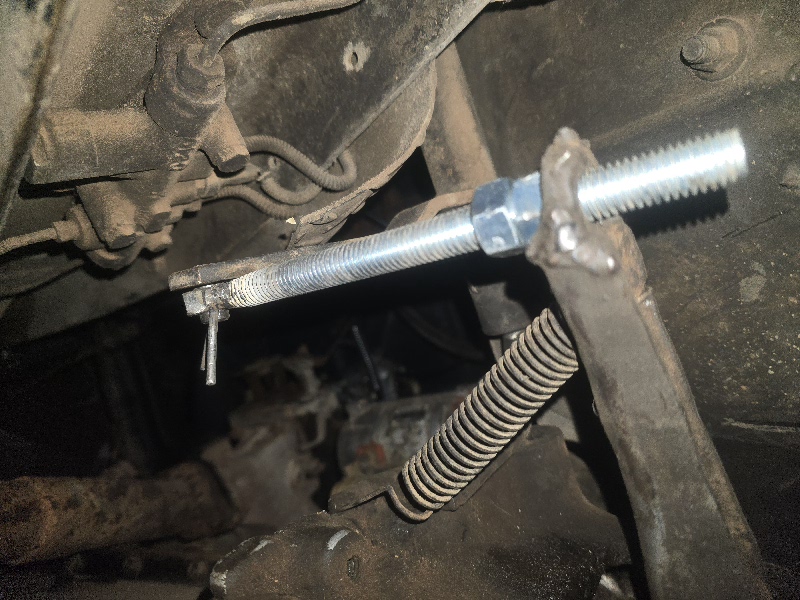

Replaced my throwout bearing in my 83 d150 now it's sticking and can't shift through the gears when I'm driving what did i do wrong. And how could I fix this.

I doubt it is something with the bearing, although it could be.
Is it linkage or Hydraulic actuated? The theory is the same as your foot transfers motion to push the bearing on the pressure plate diaphragm or fingers lifting the pressure so the clutch disc can freewheel in the open flywheel to plate ring space.
I bet the linkage is maladjusted - Check the FSM for the procedure on setting freeplay on the linkage.

So if I understand the manual right I have to adjust the nuts on the clutch side of the truck so it's has a 5/32th free play? I never touched the top just the bottom or would it be best to touch the bottom so it has that free play. From the clutch fork side

I'm not sure what your saying? Top? Bottom? There is only one adjustment point on the clutch and that is on the link between the torque shaft and the clutch fork. That is all I have ever seen. Adjust it until you have @ 1" free travel at the pedal.

Which is underneath the truck correct. Also could someone take a picture on how it looks stock because I know mine isn't stock

Is this the truck with the Ford transmission you have been talking about? Then it could have had a Ford TOB not the factory Mopar one. Did you inspect the new one and compare it to old one?

Yes I did it was the exact same one. Might have changed some parts from the ram to the Ford transmission for it to work. We made a new shift linkage just because the old one was dent and had 8 nuts on it holding it in place that's the reason why I think it's that. I do know from the fsm it has a rubber gromet on their and maybe some other things. Not sure where though. Also this is what I'm working with i have about 1 inch play at the peddle. Haven't tried it out yet but the clutch seems hard and rough like it gets stuck not smooth.
