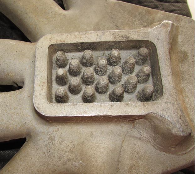

Posts: 14855
Is your intake missing the carb mounting plate?
PostPosted: Sun Jul 25, 2021 3:50 pm
Posts: 10279
Maybe..maybe not. Sure is hard to see on those low rez images :D
PostPosted: Sun Jul 25, 2021 5:46 pm
Posts: 2645
The manifold is a fabricated intake based on a 59 aluminum one barrel.
There is a large plenum welded to the outboard portion of the intake after cutting and welding.
The length is between a Weiand and a hyperpack.
Here are some more low res images.
It was professionally welded using parts I have no idea where they came from.
I think the idea was to retain carb heat but that was not functional.
The manifold was drilled today for the Holley pattern and the carb is now mounted.

Posts: 10279
Well that's why it's hard to see. 'cause it's not there.
Nice Custom parts.
