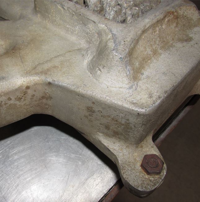

Is your intake missing the carb mounting plate?
PostPosted: Sun Jul 25, 2021 3:50 pm
Posts: 10272
Maybe..maybe not. Sure is hard to see on those low rez images :D

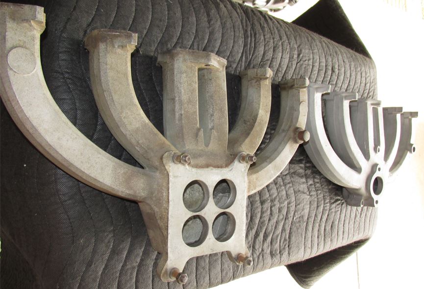

Posts: 2626
The manifold is a fabricated intake based on a 59 aluminum one barrel.
There is a large plenum welded to the outboard portion of the intake after cutting and welding.
The length is between a Weiand and a hyperpack.
Here are some more low res images.
It was professionally welded using parts I have no idea where they came from.
I think the idea was to retain carb heat but that was not functional.
The manifold was drilled today for the Holley pattern and the carb is now mounted.
PostPosted: Sun Jul 25, 2021 7:32 pm
Posts: 14850
Awesomeness!

PostPosted: Mon Jul 26, 2021 2:37 pm
Posts: 10272
Well that's why it's hard to see. 'cause it's not there.
Nice Custom parts.
Gettin it ready for Clay city to be rowin' the gears!
