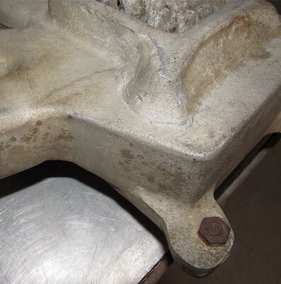

Is your intake missing the carb mounting plate?
Maybe..maybe not. Sure is hard to see on those low rez images :D

Posts: 2624
The manifold is a fabricated intake based on a 59 aluminum one barrel.
There is a large plenum welded to the outboard portion of the intake after cutting and welding.
The length is between a Weiand and a hyperpack.
Here are some more low res images.
It was professionally welded using parts I have no idea where they came from.
I think the idea was to retain carb heat but that was not functional.
The manifold was drilled today for the Holley pattern and the carb is now mounted.

Well that's why it's hard to see. 'cause it's not there.
