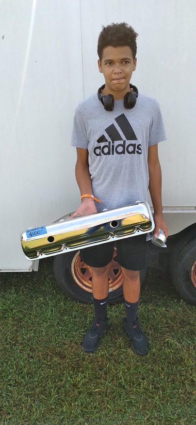

Last weekend we went to the Holley Moparty, and more good deals were had! Logan turned 15 at the show on Saturday, so I found a new chrome valve cover and breather caps as birthday gifts. Also found some long T-handle valve cover hold down bolts for when we install the cover. Engine will be looking good! One of the swap meet vendors at Moparty gave Logan a Holley 4 bbl. carb for free as a birthday gift. I told him to cherish these times, soon enough you'll be paying full retail...lol (see pics.).
