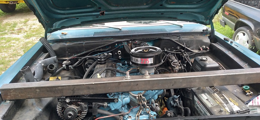

I know I haven't posted in a while, but Logan and I have been doing quite a bit of work on his Dart. I'm not doing much on the Dart when Logan isn't here, as I'm trying to teach him. Since my last post we've removed the tie rods and centerlink so we can drop the oil pan (leaking). A friend of mine loaned me a tool he made to lift the engine enough to get the oil pan out (see pic.). I'm glad he had that tool as I was stumped as to how I would support the engine. While the pan was off, I changed the rear main seal as a precaution. I would like to run full synthetic oil once we know there aren't any leaks. While I was changing the seal, Logan was doing the "fun" job of gasket scraping and cleaning, good experience for him! I also double-checked the cam gear alignment as I wasn't sure I installed it correctly when we changed the gears & chain. With the grill off and the radiator out I was able to see I was off a tooth on the cam gear, which explains why it didn't have enough power to drive up car ramps. The engine is buttoned up now, so we turned our attention to the steering.

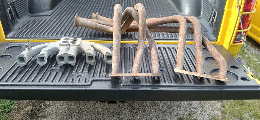

The power steering gear box isn't the only good deal we found there. I saw an old friend I knew when I lived in Joliet, IL. He had a couple of Slant 6 parts, an Offenhauser 4 bbl. intake, and a set of headers (see pic.). They will be installed at a later date.

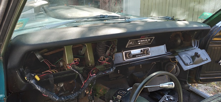

We've also bought fully rebuilt upper control arms, a recovered dash pad, which I installed today (see pics), and some '70 Dart taillight housings and an extra pair of lenses. The '72 bumper has 2 taillight openings per side, but the '70s has only one per side. We bought them as my buddy who loaned me the engine lifting tool, has a brand new '70 rear bumper he will sell Logan for $100.00. He also gave him a free hood (Logan's has a bend in the front from a P.O.). Only thing wrong with it there is a hole in the hood for a large scoop. I have an old fiberglass 6 Pack scoop that will work perfectly!

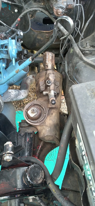

On Friday, Logan and I went to my buddy's place to check on the progress of removing both Pitman Arms and installing the A body arm onto the steering box from the Cuda. The arm came off easy from the Cuda box but would not come off the Dart's box. He wanted me to give the ok to try heating it with a torch. I told him the box is junk anyway so give it a try. Even with heat, both of us beating on it with a BFH, and while to puller was attached and tight it still wouldn't come off. Oh well. I ordered a new Pitman Arm and should be here early next week.
Today Logan and I installed the gearbox to the K-Frame. Before installing, I put the coupler onto the gearbox spline. When we tried to get the column installed, we could not get those slides to fit into the coupler. After several attempts, and lots of cussing, I gave up on trying to do it that way and pulled the steering column out and removed the coupler from the gearbox. I assembled the coupler on the steering column shaft and spent a lot of time getting everything to line up to engage the gearbox splines to the coupler...what a P.I.T.A., but it's done! Once the Pitman Arm arrives, we can install that along with the tie rods and centerlink. New idler arm is already installed.

We got the steering system installed (new tie rod ends, idler arm, and pitman arm), soon we will take it to my friend's place to change the stub strut bushings and upper control arms as he has a lift, it's hard working under a car on jack stands in a gravel driveway. Found that we couldn't install the center link with the Pitman Arm and idler arm installed without jacking up the engine, lesson learned...lol.
We installed the instrument cluster after applying white faced gauge decals to the gauges only, as we may need to find a better plastic housing. We got the steering column back in place, along with the shift linkage.

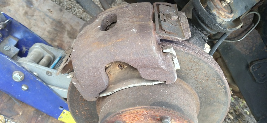

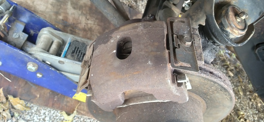

I tried to drill out the broken bleeder valve on the left front caliper without success. We decided to replace the caliper, and Rock Auto has them for a reasonable price. Looking at the pictures of calipers on RA, and other sites, we do not have that style on the Dart. The factory disc brake calipers were of a four-piston design. We have a one piston design, and I'm not sure what they originally were off of. Could anyone help me identify these calipers? I have included pics.
We began bleeding the rear brakes as everything looked good. I'm thinking the complete rearend was changed in the not-too-distant past as there are fairly new U-bolts, and it's cleaner than the rest of the undercarriage. Did find out why it takes so long to accelerate, it has 2.45 rear gears!
Anyway, when the rear was changed, they hooked up the e-brake cable to the RR, but they wire-tied the cable end to a brake line. Every time we engaged the e-brake, we were stressing the brake line. As we were bleeding the brakes, I saw the fluid spray out of the line, another repair to do (Logan is sure learning a lot!).

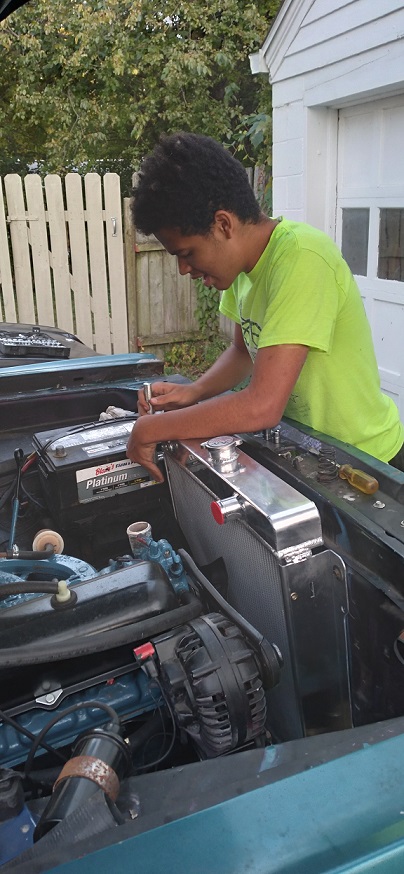

We got everything done under the hood, for now, and got her running pretty good. One of the last things we did was install one of Logan's Christmas present from last year, a new 3-row Champion aluminum radiator.
Again, if anyone can help me identify the calipers we have, we would appreciate it, thanks!

PostPosted: Tue Oct 18, 2022 12:17 am
Joined: Wed Aug 16, 2017 10:44 pm
Posts: 139
Location: Reading, Pa.
Car Model: 1982 D150 225, 2bbl., 833 OD
I'm sure one of the many A body guys on here can tell you for certain.
They sure aren't the ones that Rock Auto shows for a '72. But if you look at the offerings for a '74 Dart it shows one pot calipers. If that is the right one, they have low end rebuilds and one pricier new brand, Ultra-Power. Some of the core deposits on the rebuilds are more than the cost of the caliper.
