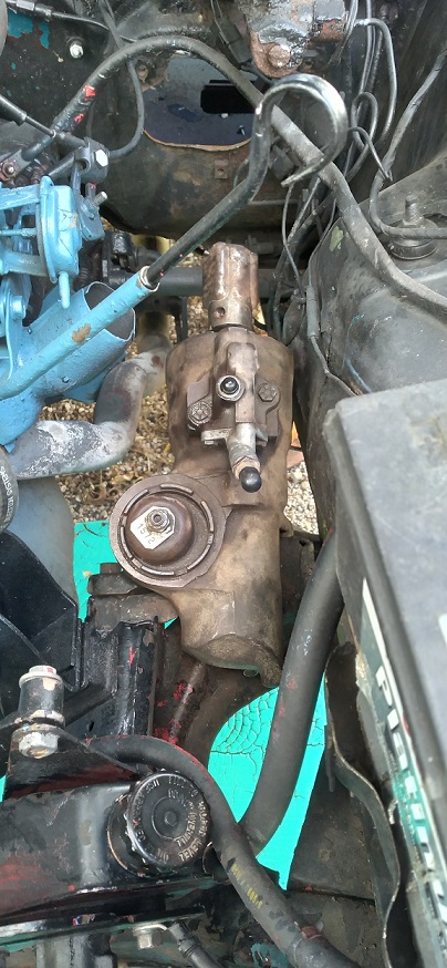

On Friday, Logan and I went to my buddy's place to check on the progress of removing both Pitman Arms and installing the A body arm onto the steering box from the Cuda. The arm came off easy from the Cuda box but would not come off the Dart's box. He wanted me to give the ok to try heating it with a torch. I told him the box is junk anyway so give it a try. Even with heat, both of us beating on it with a BFH, and while to puller was attached and tight it still wouldn't come off. Oh well. I ordered a new Pitman Arm and should be here early next week.
Today Logan and I installed the gearbox to the K-Frame. Before installing, I put the coupler onto the gearbox spline. When we tried to get the column installed, we could not get those slides to fit into the coupler. After several attempts, and lots of cussing, I gave up on trying to do it that way and pulled the steering column out and removed the coupler from the gearbox. I assembled the coupler on the steering column shaft and spent a lot of time getting everything to line up to engage the gearbox splines to the coupler...what a P.I.T.A., but it's done! Once the Pitman Arm arrives, we can install that along with the tie rods and centerlink. New idler arm is already installed.
