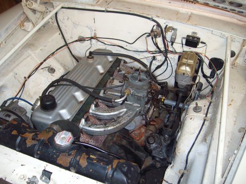

The engine is the original 170 bored .040 over. Compression is 10.0 to 1. The block and head were both shaved about .080 or .090, don't remember exactly. Steel shim head gasket. It's hard to get compression on a 170! Head has 1.81" big block exhaust valves on the intakes. Stock exhaust valves. Ported as much as I dared. Super six intake and bbd carb. I had the Erson rv10 cam and It ran very well, very peppy. But it seemed to want more carb so I made an adapter and installed a Rochester 2G that I had off of a Pontiac 350. Ran well but now it wanted more cam. So I got a Oregon 645 grind. specs. 228 @ .050" 114 lsa .296" lobe lift. Really like this cam, runs really well, but seems it wants more. I can't really go any bigger with the cam because of piston to valve clearance. So I guess I'll just run it like this for now. I don't want to get to much of this sickness or I'll never get any else done!
