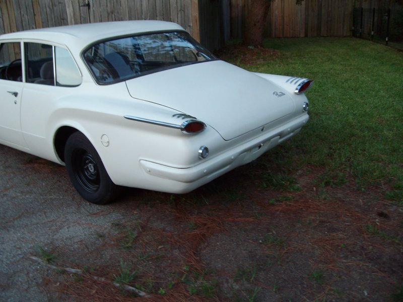

Never liked the bumpers on the early Valiant, plus mine were all dinged-up and rusty. Rear bumper I flipped, cut and welded then painted. Removed the toilet seat. Front, I just made my own valance and added some '65 barracuda turn signals. Paint is Rustoleum, flat white, gloss oyster white mixed 1 to 1.

I like the clean lack of lines on the trunk..
