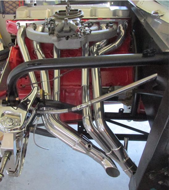

Good call Greg, Smiths is making one now and if it's correct I will get them to build a set.
Here is the engine as of today.
Intake has to come off to drill the Holley pattern.
The intake has the early AFB pattern only.

Beautiful.

Looking Great Stan! Soon the sound of Slant 6 music will be heard!! :D :D

Is your intake missing the carb mounting plate?
Maybe..maybe not. Sure is hard to see on those low rez images :D

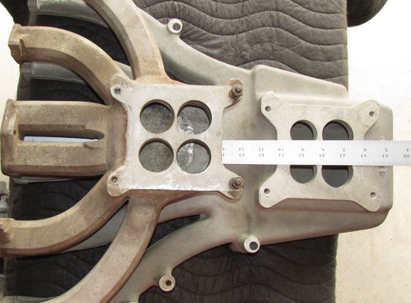

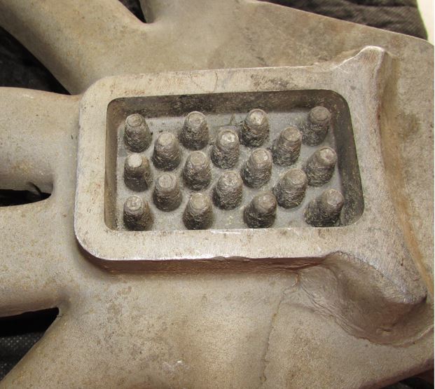

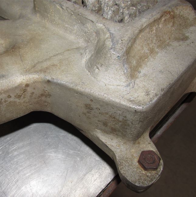

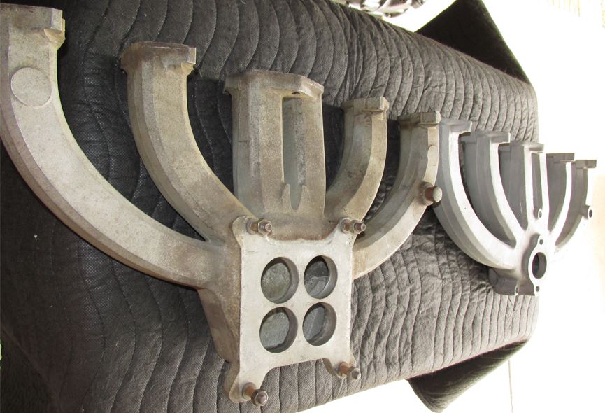

The manifold is a fabricated intake based on a 59 aluminum one barrel.
There is a large plenum welded to the outboard portion of the intake after cutting and welding.
The length is between a Weiand and a hyperpack.
Here are some more low res images.
It was professionally welded using parts I have no idea where they came from.
I think the idea was to retain carb heat but that was not functional.
The manifold was drilled today for the Holley pattern and the carb is now mounted.

Well that's why it's hard to see. 'cause it's not there.
Nice Custom parts.
