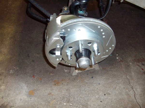

Scarebird conversion

Do you have small bolt pattern in front and big bolt pattern in the rear with the ford 8.8?
It looks like you have a front sway bar... what application is it for?
Thanks
 Post subject: Re: '61 Valiant
PostPosted: Sun Jul 31, 2022 8:01 pm
Joined: Fri May 30, 2003 4:32 pm
Posts: 131
Location: Northwest FL
Thanks Greg. Yes it's small bolt pattern in the front, trying to keep the weight down. The disc brakes still weigh about 2lbs more per side. The sway bar was off of a '57 Desoto, I think it was 3/4". I had to cut it down and weld some new ends on it. Makes all the difference in handling. I think there are many possible donors at the junk yard. Just want to make sure that it's inside the strut rods or the calipers will hit.
